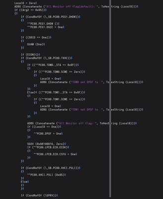

Looking at the occurences of GLCK in the SSDTs/DSDT, it seems to indeed be responsible for at least switching off the monitor, judging by the logs on the first screenshot:
There's also this portion of code that controls GLCK through GUAM, and IIRC RPL1/SPL1 both makes updates to the fan control PWM signals:
This is not an exact science, but at least I've tried understanding what is going on here from the software side of things. It would be great to take a look at the implementation of the EC, but I sadly do not have the hardware tools to do it. It isn't exposed to the processor or through the ACPI declarations.
