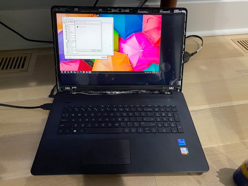

I recently purchased hp 17t-by400. I didn't realize it had 720p screen. I was unable to cancel the order. I love the laptop except the screen. It has limited resolution and being glossy it reflects a lot.
I purchased 798926-009 screen.
It occasionally get to work but the picture is limited to only part of
it. Please refer to picture attached.
When I reboot bios does not recognize it but recognize external monitor if I attach second monitor.
I removed intel driver, updated driver and I even reinstall windows but but no luck. Display settings does not give me option higher then 1600x900.
It almost seems like HP software or bios is limiting the possibility.
I would really appreciate any suggestions. I am really relying on this community to make it work.
Found the answer
 i need to upgrade the cable to upgrade my screen from HD+ aka 720p to FHD aka 1080p.
I will need cable L22520-001 which is not available anywhere.  In fact most of the display cables are not easily available making it impossible to upgrade screen if you don’t like what you ordered. Hope that helps someone.
i have to get rid of the laptop. Also important to note here that I realized that I ordered wrong screen, contacted hp right away but couldn’t get response at all and couldn’t change order.
 At this point as I have upgraded memory and other stuff thinking I will be able to change screen as well. I think I am out of luck. Lesson learned.

thank you for responding to my question Praveen.
I didn’t clarify the issue I guess.
i replaced the 720p glossy screen with the new screen (part number 798926-009) 1080p which should be supported by irisXe.
 With the new screen, the picture only occupies 3/4 of the screen as shown in picture. and if I reboot the bios doesn’t recognize the screen and it goes blank. Again I did play around with display settings, display drivers and even reinstalling windows from scratch.
It has nothing to do with video playing.
Let's try these steps
Intel® Driver & Support Assistant  the Intel High-Definition (HD) Graphics,
These are the compatible display for this model refer to page 31 HP 17 Laptop PC Maintenance and Service Guide. link
You may order the replacement parts on the HP Parts Store, use the HP Parts Surfer to find the part number and If you've already looked for it and couldn't find it on the HP Parts Store, you may want to get it locally at the online store such as Amazon or eBay, etc...as the part numbers are universal.
Have a great day!
I tried several things, including Intel driver and support link that you mentioned, display adapter settings and even reinstalling windows. So yes I tried that step earlier.
 It doesn’t identify it as second screen  as generic pnp monitor (even external display is attached) but don’t think that it needs another driver etc. also the display settings doesn’t give option to go above 1600x900 to 1920x1080.

Thank you again Praveen to try to help me out. I will live with original screen. It really doesn’t looks like hardware issue.
I am afraid of ordering even recommended screen that you mentioned above, at this point. I am concern that they may not work either. I wonder if anyone else have tried replacing screen with recommended part number with this model.
Found the answer
Found the cable here but the price is not good:
https://www.ebay.com/itm/HP-L22520-001-Kabel-Full-HD-17-D/143792725286?epid=14041788516&hash=item217...
If you want me to keep looking I have a pretty good success rate finding obscure parts
That’s really nice of you. That’s too expensive for me.
 Thanks again
