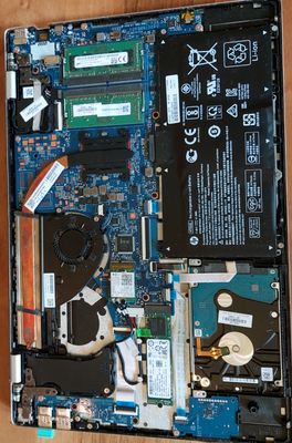

- Location cmos battery 15-cs0925nd laptop
Common problems for Battery
1 REPLY 1
09-27-2025 06:32 AM - edited 09-27-2025 06:33 AM
Hi:
Your notebook does not have a CMOS/RTC battery.
The main battery also serves as the CMOS/RTC battery that maintains the BIOS and system clock settings.
Below is the link to the service manual:
Chapter 3 has the list of parts.
You will not find a CMOS/RTC battery part number.
Chapter 5 has the component removal and replacement procedures.
You will not find a procedure to remove/replace a CMOS/RTC battery.
