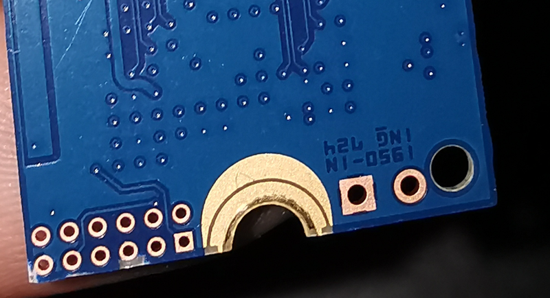

   Thanks for all the help. I was able to find out the issue for now, the Kingston drive has some damage to the end of it. Not sure what caused it, seems manufacturer. I ended up getting my hands on a silicon power M.2 drive (couldn't get one in the links in time) and so far it works well. Will definitely take all the advice for any future decision s. This is a pic of the damaged drive (see it at the bottom):Kingston SSD Failure.png
This drive was installed brand new and has less than 100hrs on it.

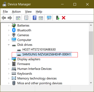

My Omen machine has 256GB of Samsung
Probably yours is also Samsung.

I have read of this issue before and its rare but does happen. The fix was to replace the SSD in all cases I've read.
The fault is not brand specific either. It can happen on any m.2 drive. The most believable theory I've read is a defect in soldering. Not sure how true that is, but plausible.

The soldering issue would explain why it needs to heat up.
