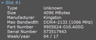

I currently have a stock 4GB 2133MHz on my machine, and added another 4GB 2133MHz. I'm thinking on upgrading to 16GB (2x8GB) but I'm having a hard time searching locally for the same frequency. Can I change to two sticks with 2400MHz each?

I experience using 2400MHz last 2 years ago. Because they said the exact thing you said, that it will run matching with the lowest stick. But I always experience blue screen. Now I'm puzzled if I change both to 2400MHz will I experience hardware failure or not?

So even I place two 2400Mhz sticks, it will still run at 2133Mhz?

Yes that's right it is DDR4-2400 "bridged" to 2133. If Crucial does not have the memory try Kingston (but stay away from KVR Kingston Value RAM modules-HP laptops seem to have issues with them.) If Kingston does not have it post back and tell us where you live (country) and we will help you locate compatible memory.

I have added an additional RAM almost 2 years ago, purchase in my local country.
