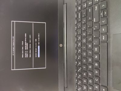

Hi, I couldn't sign in again due to Google issue.
I have made all checks from diagnostics but only memory check is fails.
So hardware check is successful just memory check.
I have attached a picture from diagnostics.
OK, now we know for sure that the problem is a memory module.  The problem now is to replace the memory with a compatible replacement.  In trying to find out more about the laptop - the HP Support or even Google search does not report finding that model number.
So physical inspection of the memory installed is the way to match the existing modules.  Remove the memory and find the make and model number and catalog number to find a replacement.
