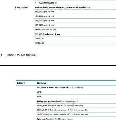

Page 3 of the users manual for your 15-Da1013ny indicates you may have
A single 1tb HDD and a 16gb Optane memory (M.2)
If that is correct then you should replace the Optane with the exact part
Optane memory module, 16 GB L20383-001
the above applies to Intel motherboards only.
If you have only a M.2 SSD then you can clone it to a much bigger one up to 4tb

My current storage Configuration is 1TB  HDD + 128GB M.2 Sata SSD.
I want to replace 128GB M.2 Sata SSD with New M.2 PCIE SSD.
So here in manual it's written two options for M.2 PCIe Ssd 256GB and 512GB.
Can I install 128GB Nvme PCIe SSD.
Yes, that document (naar very bottom) states
PCIe,  NVMe, M.2
I recommend you use the 1tb Crucial here as they state it is compatible with HP 15-da1013ny
