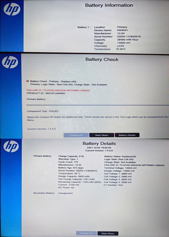

When you get a replacement battery pack installed, boot up into the F2 diagnostic menu. Select Components -> Power -> Battery, and run a test. After that completes click on Details. It'll show a lot of useful info about the battery, such as age (how long since it was manufactured), number of charge cycles, rated mAh, charged mAh, percentage charge capability, rated voltage, tested voltage, and the individual mAh charge levels of each internal battery cell. This way you can confirm that your replacement battery is indeed new and performing to spec.
Here's the readout on my previous dying 3rd party no-name battery pack:
Despite it showing charge capacity of 51%, my laptop would be unable to run more than a few minutes on the battery pack before suffering an abnormal shutdown. The glaring note here is that one battery cell is appreciably lower than the others, by about 800 mAh. This one failing cell ends up compromising the entire pack. The firmware doesn't seem to tolerate it well. So it also fails to communicate properly with Windows... which is why it doesn't let Windows know that battery level is critical.
The battery I received appears genuine and is nicely performing to spec, in fact even a little higher in voltage and total mAh.
You can see the manufacture date is late 2017. Despite it having been in storage for 3 years, it is unused and should perform well for the next 2~3 years.
