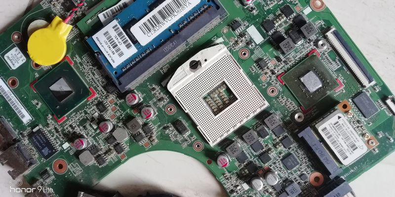

Please how do i recognize the Nvidia GPU on my motherboard
And thanks for the reply although I won't be with my PC for a few days🙂
Yh the troubleshoot step 1 point 2 it once showed Basic Display Adapter but then also I tried installing my GPU[no Nvidia GPU detected] was all I got so I accidentally uninstalled the device because I had no idea what it was😥😢 the former was GeForce 820m though I never really paid attention to Intel so I don't know if it was there before or not
sorry for the late reply ii tried reinstalling windows 10 to the 22H2 version normally i was expecting miracles
but to no avilthis is what came back after window reinstallationthis is what came back after window reinstallationlocation is unknownlocation is unknowncan you pls explain what kinda hardware id is thiscan you pls explain what kinda hardware id is thisdis3.png
or could it be from the BIOS or the BIOSstill kinda sad cuz i reallly dont wanna let it gostill kinda sad cuz i reallly dont wanna let it go

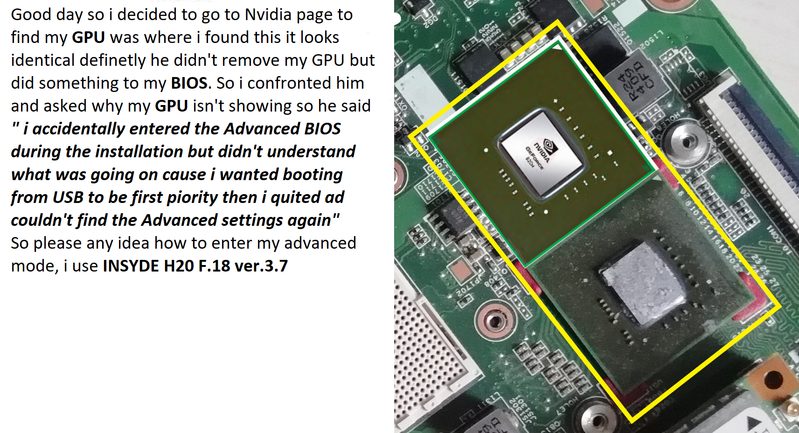

He didnt change my board i noticed those number {CP1430} on all my hardware partsHe didnt change my board i noticed those number {CP1430} on all my hardware partsNoticed a fresh thermal paste so i cleaned and re paste new thermal paste  I dont know if that is the CPUNoticed a fresh thermal paste so i cleaned and re paste new thermal paste I dont know if that is the CPUBut pls is this the GPU port or the CPU portBut pls is this the GPU port or the CPU portBut only the fan had a different numberBut only the fan had a different number
@Gaya1239 I need a quick response
Hi .@Gaya1239 my Intel turbo boost technology was also mistakenly disabled how do I fix it from the bios
