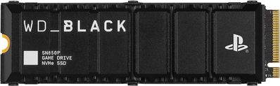

The question is if the HP SSD  shield has the function of a heatsink or if i buy a new SSD i need to use the heatsink from the manufacture and it will fit inside the HP SSD shield or i will insert the SSD without this HP shield ??
HP Shield:
Without Heatsink:
With Heatsink from Manufacture:
Same for 990Pro
Without Heatsink:
990Pro with Heatsink:
That second image  and the fourth images actually show heatsinks. There is a thermal pad between it and the chips on the SSD circuit board.
The fancy heatsinks from the manufacturer aren't really needed as long as you keep the  air intake and exhaust ports clear of dust.
