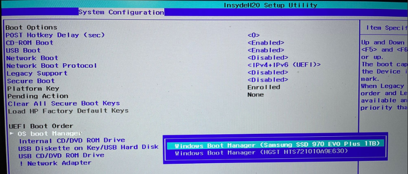

If you want to keep the HDD the way it is and automatically boot from the SSD, see if your BIOS allows you to do so.
Go into F10 BIOS Setup -> System Configuration ->UEFI Boot Order. Click OS Boot Manger, and if you see the HDD and SSD, as shown in this screenshot, use F5 or F6 key to move up the SSD to the top and save and exit to restart. Your system now should always boot from the SSD.
If you see only the HDD, you need to delete the EFI partition on the hard drive that contains the Windows boot manager. If you do this, you can view the content of the HDD from Windows on the SSD but no longer can boot from the HDD.
