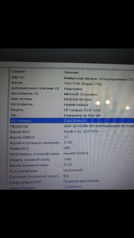

I just start up nb, and bios show me next info. I couldn't understand what's goes wrong)

The picture repesents a
D5A63EACompaq Presario CQ58-325ER
Here is SKU.
Here is case photo.
So, what I should to do?
