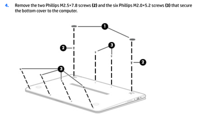

I need replacement screws for my HP Envy x 160.  The (4) screws that hold the laptop together externally. The little rubber covers would be nice to replace, hence they are all gone. LOL.
I don't know the size and don't want to buy a pack with a million in them.  Please help!

Hello @DVA4GOD,
As shown by the image below, there are a total of 6 screws holding down the bottom cover:
You can attempt to search those screw models online or you can also check in with tech repair shops nearby to see if they have them available.
There's also a separate screw kit with HP Spare Part number 856797-001.
The rubber kit (includes bottom cover rubber feet) has HP Spare part number 856816-001.
You can find parts through the HP Parts Store. You'll find the majority of parts available there but it's common for them to be back-ordered or unavailable. You may be able to find the part online through third-parties by searching those part numbers.
