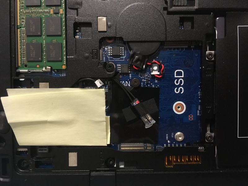

Thanks Banhien for your reply. The picture has been removed because there was a serial number visible.
I do have a M.2 slot as you can see on the picture. It is named as DIMM2. Can I use this as a 2nd storage device or is it only for RAM?
There is another space with two wires available. Could this be something to connect with a storage device?
