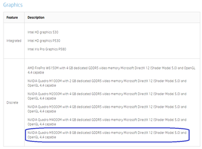

According to: HP ZBook 17 G3 Mobile Workstation Product Specifications | HP® Customer Support, you already have the most powerful discrete graphics card installed.
