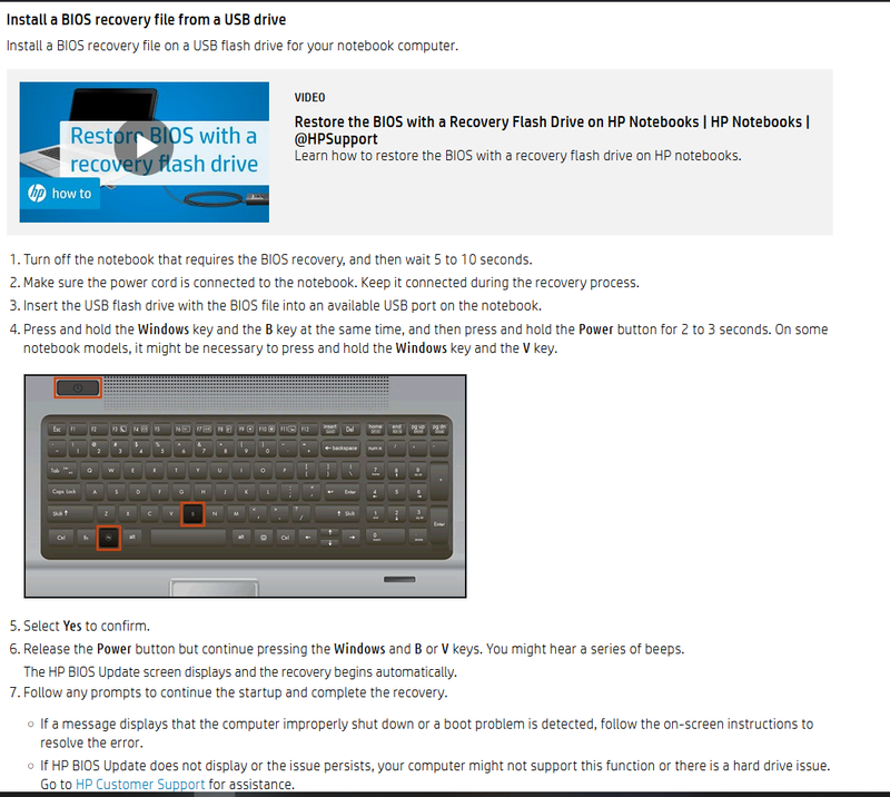

Probably the link does not lead anywhere because I live in Europe and therefore I use a European IP, to me it opens without problems. Now I attach some images.
010102020303040405050606
What you see in the image is the procedure that I tried to follow, but without success.
