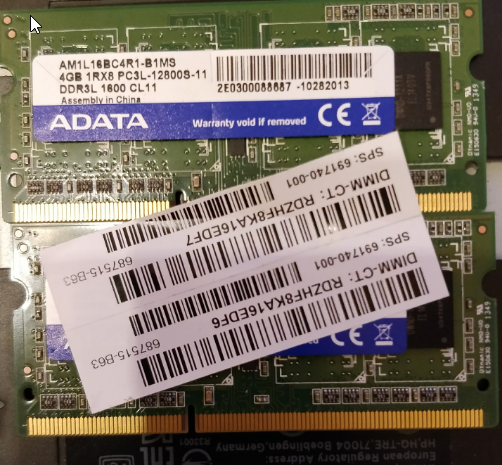

The RAM itself is stock RAM that came with the machine. Please see the photo attached for the RAM ID's, it's AData RAM.

This is a puzzler and should not be happening. The memory is identical sticks and compatible specs.
