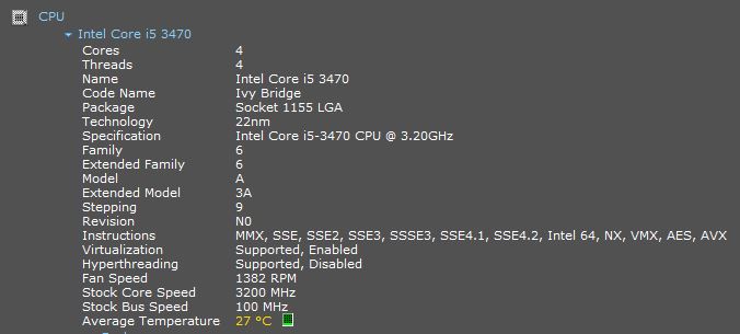

> Speccy is not showing the fan RPM anywhere.
It does, for me:
