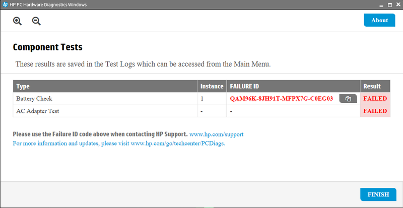

Probook 450 G3 i7
Dears,
After upgrading my BIOS as recommended by the HP Support Assistant, the battery is not charging and if I unplugged my Laptop it shuts down immediately. Prior to that update the battery held charge for more than 2 hours and it was working perfectly. Luckily I’ve done a battery check before and after the BIOS update and I have screenshots as I was in an online meeting which required me to record the session. I’ve tried uninstalling the driver for “Microsoft ACPI-compliant control method battery” as recommended in this post https://h30434.www3.hp.com/t5/Notebook-Hardware-and-Upgrade-Questions/Plugged-in-not-charging-after-... which had the same issue that I’m having. Any suggestions?Before.pngAfter.png

Unfortunately, I followed the steps to the book and it’s still not charging. The BIOS update messed everything up. The Laptop is extremely slow after the update. I’m running windows 10 x64 enterprise with an i7 Processer and 16GB of RAM.
Thanks & Best Regards

I had to remove the battery so the test can complete. Because it gave me an error once it started. Also, I've done the Power test through the windows and I've attached the results. Thanks

2018-02-22 10:14:19  Power Source Test Selected
2018-02-22 10:14:19  Estimated Total Time Required = 240s
2018-02-22 10:14:19  Battery Test Started
2018-02-22 10:14:21  [L]> EfiBatteryLibGetSmartAdapterStatus: AdapterStatus is '1'.
2018-02-22 10:14:21  System reports 1 batteries supported.
2018-02-22 10:14:21  Will not check battery charging since the remaining capacity is bigger than 90
2018-02-22 10:14:21  [L]> Battery cell voltage difference is out of range. MaxCellVolt(4297 mV), MinCellVolt(3778 mV).
2018-02-22 10:14:21  Battery 0 returned 0x0000000000000040 -- Retrying
2018-02-22 10:14:24  Will not check battery charging since the remaining capacity is bigger than 90
2018-02-22 10:14:24  [L]> Battery cell voltage difference is out of range. MaxCellVolt(4297 mV), MinCellVolt(3778 mV).
2018-02-22 10:14:24  Battery 0 returned 0x0000000000000040 -- Retrying
2018-02-22 10:14:27  Will not check battery charging since the remaining capacity is bigger than 90
2018-02-22 10:14:27  [L]> Battery cell voltage difference is out of range. MaxCellVolt(4297 mV), MinCellVolt(3778 mV).
2018-02-22 10:14:27  Battery 0 returned 0x0000000000000040 -- Retrying
2018-02-22 10:14:30  Battery 0 returned 0x0000000000000040
2018-02-22 10:14:30  Overall Battery Result = 3
2018-02-22 10:14:30  Error Code=0x601
2018-02-22 10:14:30  Serial Number       : 5CD6225544
2018-02-22 10:14:30  Warranty Start Date : 04/21/2016
2018-02-22 10:14:30  WarrantyIDString size = 60
2018-02-22 10:14:30  Warranty ID = QAM96K-83G91M-MFPX7G-C09903
2018-02-22 10:14:56  Power Source Test Completed

2018-02-25 15:35:16  Power Source Test Selected
2018-02-25 15:35:16  Estimated Total Time Required = 240s
2018-02-25 15:35:16  Battery Test Started
2018-02-25 15:35:18  [L]> EfiBatteryLibGetSmartAdapterStatus: AdapterStatus is '1'.
2018-02-25 15:35:18  System reports 1 batteries supported.
2018-02-25 15:35:18  Battery 0, Invalid Design Voltage 8400
2018-02-25 15:35:18  Battery 0 returned 0x0000000000000060 -- Retrying
2018-02-25 15:35:21  Battery 0 returned 0x0000000000000060
2018-02-25 15:35:21  Overall Battery Result = 6
2018-02-25 15:35:21  AC Adapter Test Started
2018-02-25 15:35:23  [L]> EfiBatteryLibGetSmartAdapterStatus: AdapterStatus is '1'.
2018-02-25 15:35:23  AC Adapter Test Completed - Result 1
2018-02-25 15:35:28  Power Source Test Completed

2018-02-25 15:36:57  Battery Test Selected
2018-02-25 15:36:57  Estimated Total Time Required = 120s
2018-02-25 15:36:57  Battery Test Started
2018-02-25 15:36:59  [L]> EfiBatteryLibGetSmartAdapterStatus: AdapterStatus is '1'.
2018-02-25 15:36:59  System reports 1 batteries supported.
2018-02-25 15:36:59  Will not check battery charging since the DeepDischarge variable is TRUE
2018-02-25 15:36:59  [L]> Battery cell voltage difference is out of range. MaxCellVolt(4289 mV), MinCellVolt(2417 mV).
2018-02-25 15:36:59  Battery 0 returned 0x0000000000000040 -- Retrying
2018-02-25 15:37:02  Will not check battery charging since the DeepDischarge variable is TRUE
2018-02-25 15:37:02  [L]> Battery cell voltage difference is out of range. MaxCellVolt(4289 mV), MinCellVolt(2417 mV).
2018-02-25 15:37:02  Battery 0 returned 0x0000000000000040 -- Retrying
2018-02-25 15:37:05  Will not check battery charging since the DeepDischarge variable is TRUE
2018-02-25 15:37:05  [L]> Battery cell voltage difference is out of range. MaxCellVolt(4289 mV), MinCellVolt(2417 mV).
2018-02-25 15:37:05  Battery 0 returned 0x0000000000000040 -- Retrying
2018-02-25 15:37:08  Battery 0 returned 0x0000000000000040
2018-02-25 15:37:09  Overall Battery Result = 3
2018-02-25 15:37:09  Error Code=0x601
2018-02-25 15:37:09  Serial Number       : 5CD6225544
2018-02-25 15:37:09  Warranty Start Date : 04/21/2016
2018-02-25 15:37:09  WarrantyIDString size = 60
2018-02-25 15:37:09  Warranty ID = QAM96K-83G91Q-MFPX7G-C0FR03
2018-02-25 15:37:28  Battery Test Completed, TestResult = 3

2018-02-26 22:58:04  Battery Test Started
2018-02-26 22:58:06  [L]> EfiBatteryLibGetSmartAdapterStatus: AdapterStatus is '1'.
2018-02-26 22:58:06  System reports 1 batteries supported.
2018-02-26 22:58:06  Will not check battery charging since the DeepDischarge variable is TRUE
2018-02-26 22:58:06  [L]> Battery cell voltage difference is out of range. MaxCellVolt(4289 mV), MinCellVolt(1081 mV).
2018-02-26 22:58:06  Battery 0 returned 0x0000000000000040 -- Retrying
2018-02-26 22:58:10  Will not check battery charging since the DeepDischarge variable is TRUE
2018-02-26 22:58:10  [L]> Battery cell voltage difference is out of range. MaxCellVolt(4289 mV), MinCellVolt(1081 mV).
2018-02-26 22:58:10  Battery 0 returned 0x0000000000000040 -- Retrying
2018-02-26 22:58:13  Will not check battery charging since the DeepDischarge variable is TRUE
2018-02-26 22:58:13  [L]> Battery cell voltage difference is out of range. MaxCellVolt(4289 mV), MinCellVolt(1081 mV).
2018-02-26 22:58:13  Battery 0 returned 0x0000000000000040 -- Retrying
2018-02-26 22:58:17  Battery 0 returned 0x0000000000000040
2018-02-26 22:58:17  Overall Battery Result = 3
2018-02-26 22:58:17  Error Code=0x601
2018-02-26 22:58:17  Serial Number       : 5CD6225544
2018-02-26 22:58:17  Warranty Start Date : 04/21/2016
2018-02-26 22:58:17  WarrantyIDString size = 60
2018-02-26 22:58:17  Warranty ID = QAM96K-83G91R-MFPX7G-C0F903

2018-02-27 11:14:51  Battery Test Started
2018-02-27 11:14:53  [L]> EfiBatteryLibGetSmartAdapterStatus: AdapterStatus is '1'.
2018-02-27 11:14:53  System reports 1 batteries supported.
2018-02-27 11:14:53  Battery 0, Invalid Design Voltage 8400
2018-02-27 11:14:53  Battery 0 returned 0x0000000000000060 -- Retrying
2018-02-27 11:14:56  Battery 0 returned 0x0000000000000060
2018-02-27 11:14:56  Overall Battery Result = 6

Sorry for being pushy. Has the report shown you anything? Thanks
Any luck? The laptop is really slow and it takes around a minute to bypass the POST with the HP Logo. I wish I didn't follow the HP Support Assistance recommendation by updating the BIOS.
Hi Balamita,
Sorry for the late reply. During the Hardware test, youve mentioned removing the battery because its giving you an error? Can you please post the error message?
Please dont remove the battery as this is the main reason why we are asking you to run a test to check your battery.
Regards,
ichi
"Education costs money; so does Ignorance"
If my post has helped you, click the Kudos Thumbs up!
If it solved your issue, Click the "Accept as Solution" button so others can benefit from the question you asked!
Appreciate your support. As an update I've installed a new windows even if it might not be irrelevant. The POST still hangs in there for around 30 to 40 seconds before loading the windows.
Here're the Logs:

2018-03-09 19:08:49  [L]> EFI_HP_BATTERY_CONTROL_PROTOCOL_2010 is present.
2018-03-09 19:08:49  Type 11 1 tables
2018-03-09 19:08:49  Type (000000000000000Bh), Len (0000000000000005h), Handle (000000000000000Fh), String count (0000000000000003h)
2018-03-09 19:08:49  HPBATDET: Environment Variable not found.
2018-03-09 19:08:49  BATDET: Date 4//21//2016
2018-03-09 19:08:49  BATDET: 0
2018-03-09 19:08:49  [L]> BATDET: HP
2018-03-09 19:08:49  Retrieved BatterySafetyMode: 0.
2018-03-09 19:08:49  Starting Graphical System Diagnostic Menu
2018-03-09 19:08:54  System Extensive Test Selected
2018-03-09 19:08:54  [L]> Total Memory 16290MB, Free 15997MB (4095410 Pages)
2018-03-09 19:08:55  [L]> Calculated 0x000000007F9FE888 TSC Ticks per MB.
2018-03-09 19:08:55  Found 4 Partitions on Drive
2018-03-09 19:08:56  SectorPerCluster 0x8
2018-03-09 19:08:56  Cluster Size 0x1000
2018-03-09 19:08:56  Partition has 0x7F800 Clusters
2018-03-09 19:08:56  Volume is FAT32
2018-03-09 19:08:56  Drive 0, Partition 3 - Decoding FAT data
2018-03-09 19:08:56  Partition Starting LBA 0x74301800
2018-03-09 19:08:56  Partition Size in LBA 0x400000
2018-03-09 19:08:56  Partition (FAT32) Clusters: Read=0x474A Skipped=0x7B0B6 Total=0x7F800
2018-03-09 19:08:56  NTFS Blocks Used 6227985, Free 1386495
2018-03-09 19:08:56  EXT3 Blocks Used 0, Free 0
2018-03-09 19:08:56  FAT32 Clusters Used 18250, Free 503990
2018-03-09 19:08:56  Estimated Total Time Required = 30028s
2018-03-09 19:08:56  Battery Test Started
2018-03-09 19:08:58  [L]> EfiBatteryLibGetSmartAdapterStatus: AdapterStatus is '1'.
2018-03-09 19:08:58  System reports 1 batteries supported.
2018-03-09 19:08:59  Will not check battery charging since the DeepDischarge variable is TRUE
2018-03-09 19:08:59  [L]> Battery cell voltage difference is out of range. MaxCellVolt(4285 mV), MinCellVolt(158 mV).
2018-03-09 19:08:59  Battery 0 returned 0x0000000000000040 -- Retrying
2018-03-09 19:09:03  Will not check battery charging since the DeepDischarge variable is TRUE
2018-03-09 19:09:03  [L]> Battery cell voltage difference is out of range. MaxCellVolt(4285 mV), MinCellVolt(158 mV).
2018-03-09 19:09:03  Battery 0 returned 0x0000000000000040 -- Retrying
2018-03-09 19:09:06  Will not check battery charging since the DeepDischarge variable is TRUE
2018-03-09 19:09:06  [L]> Battery cell voltage difference is out of range. MaxCellVolt(4285 mV), MinCellVolt(158 mV).
2018-03-09 19:09:06  Battery 0 returned 0x0000000000000040 -- Retrying
2018-03-09 19:09:09  Battery 0 returned 0x0000000000000040
2018-03-09 19:09:10  Overall Battery Result = 3
2018-03-09 19:09:10  Error Code=0x601
2018-03-09 19:09:10  Serial Number       : 5CD6225544
2018-03-09 19:09:10  Warranty Start Date : 04/21/2016
2018-03-09 19:09:10  WarrantyIDString size = 60
2018-03-09 19:09:10  Warranty ID = QAM96K-83G924-MFPX7G-C09W03
2018-03-09 19:09:41  System Extensive Test Completed
I'm sorry for being pushy but it's getting on my nerves. It takes almost 30 to 40 seconds to get by the POST after a fresh windows installation. The Laptop itself seems to be very slow. Any ideas? Is it safe to downgrade the BIOS?
