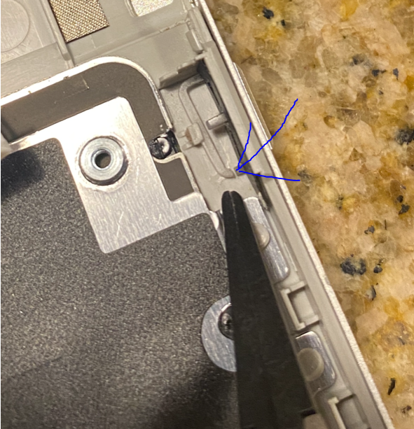

I have a laptop that needs the power button replaced. Not the power button that is on the motherboard, but on the external frame of the computer. It appears the plastic piece is broken and needs to be replaced. When the button is pressed, the plastic part does not touch the power button on the motherboard making the laptop useless.

Here's the Service Guide for that model- http://h10032.www1.hp.com/ctg/Manual/c05527167.pdf
It doesn't show a part number for the button, looks like a new top cover with keyboard is the only option.
