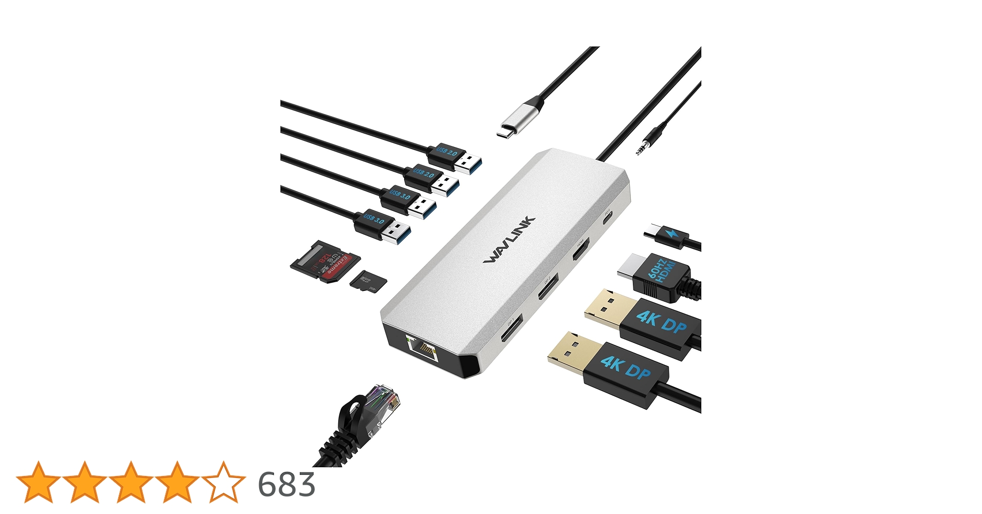

As for the link of the docking,please kindly refer to the link below:
https://www.amazon.ca/gp/product/B0CHHX7WYN
It is a type-c docking.The type-c power adapter could be connected to the pd port of the docking.
It could charge the laptop and provide the power for the usb peripherals which connects to the docking.
If I connect a 100w power adapter to this docking,it could provide 85w for the laptop at most because 15w from the power adapter will be used to power the usb peripherals etc.
And that is what I am worrying about.
I learnt that some laptop could not be charged if the power adapter could not provide enough power.And the system will not detect any power adapter even it is connected.
For example,a laptop is designed to work with a 100w power adapter,when you connect a 30w power adapter to the laptop,the system might not detect the power adapte connected.
While for some laptop,even the power adapter could not provide enough power,the system could detect the power adapter connected,however the performance might be limited.
So I wonder if the docking could only provide 85w for the 14t-ew100,will the laptop detect the power adapter connected when I connect the 100w power adapter to the docking?

That is the Maintenance & Service guide for your laptop as well as for the 14-ew0xx laptop.
A USB Type-C power adapter of 65W or greater should work if plugged into the USB  Gen4 Type-C Thunderbolt port.
Look for the lightning bolt symbol next to the port.
