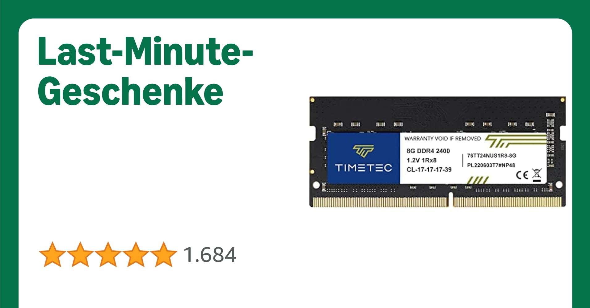

Here is the problem. That is gaming or low latency memory. HP notebooks are designed to work with stock OEM memory with standard timings. If you purchase Hynix or other standard DDR4 memory you will have no problem. You are far from the first to run into this. Pretty sure nobody from HP suggested the specific memory you chose. Yes, you can install 2 x 16 = 32 gigs if you wish.
Timetec by Hynix is a good standard memory and has become the amazon.com house brand.
https://www.amazon.de/Timetec-PC4-19200-Unbuffered-Notebook-Computer/dp/B078SJ72FC/ref=sr_1_22_sspa?...
This is CL=16 and the memory you bought is CL=14. Its a big difference. A desktop motherboard would probably alter the clock settings of the faster memory to make it work but notebooks do not always do that. Whether its intentional or not I do not know.
Thank you really much for your prompt answer! So, everything is clear now, I'll sell the RAM modules and will buy a kit with fitting latency. I still don't appreciate the fact this unbendable requirement is stated absolutely nowhere in all of the official and unofficial documents I've been through. Thank you nevertheless, problem solved! 😊
