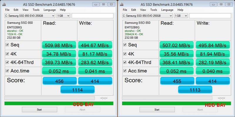

Some side quest, that I've also tried is to chech the SSD behaviour. And it seems that in my laptop fortunatelly the caddy does not diminish the strenghts of the SDD. I'm not saying that is the situation of all HP laptops, but in this case the second port is similar with the primary SATA port.
The results in left picture is obtained with the SSD mounted in the bay area and HDD in its bay.
The right picture is only with the SSd mounted into the HDD bay.
In both situations the tests were made in a fresh install of Win 8 Enterprise x64

This is a workaround. You are not really booting from the SSD in the optical bay you are booting from the hard drive in the main bay. And this is way too complicated for most peope to implement.I would be curious to see a Sandra report on whether the optical bay port is SATA III or some lower version of SATA. But I will admit the read and write speeds on the SSD in the optical bay are higher than I thought they would be.

Thanks for the Sandra hint. I've just find out that my HDD is a SATA300 not 600 🙂 Look at the screenshots
