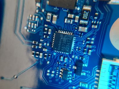

Another thing that I highly doubt is an integrated circuit located next to the battery connector called intersil with number 88739B second line W234T7.
I am aware of electronics to the extent that if the problem is completely this AC, I can replace it myself.
I think the fake adapter damaged this AC.
Is it possible that this AC is broken according to HP engineers and technicians?
One request I have from you is how can I find the motherboard diagram and schematic of this laptop to understand the problem more accurately?
Do you know a site or program that provides motherboard schematics for laptops?
Does the HP site provide schematics and routing?
I expect you to provide such specialized advice 🙏
