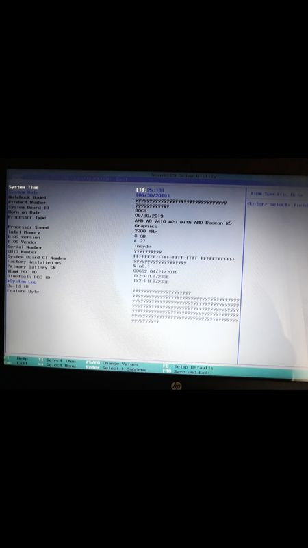

After a bios update, the system serial numbers (Product Name and Serial, Product Number, System Board CT) were deleted in the bios information. It is not possible to start system recovery without this Serial Numbers. I can't start my laptop and recover my original operative system with DVD's recovery tools.
When I turn on my notebook I can see the following message:
Product Information not valid
"The following product information programmed into the system board is missing or invalid.
System Board (00A) - Product Name
System Board (00A) - Product Serial Number
System Board (00A) - Product Number
System Board (00A) - System Board CT Number"
ENTER - Continue Startup
www.hp.com/go/techcenter/startup
----------------------------------------------------------------------------------------------------------------------------Screenshot_20190630-184514_Gallery.jpgScreenshot_20190630-184532_Gallery.jpg
Please, I need help, thank you.

I download the tool from the Hewlett-Packard website that allows me to configure the Bios by entering the serial numbers and follow the steps, but when I run I get an error because the motherboard is in LOCK mode.
I wish you'd make it easy for me to put the board into UNLOCK mode so I could record my serial numbers. Thanks a lot.

The Notebook needs to be sent for serviced where the BIOS can be tattooed with the SN and PN.
Please contact HP Support for Service Options
Click on this link - https://support.hp.com/us-en/contact-hp?openCLC=true and select your Country to get the Contact details for HP Support
