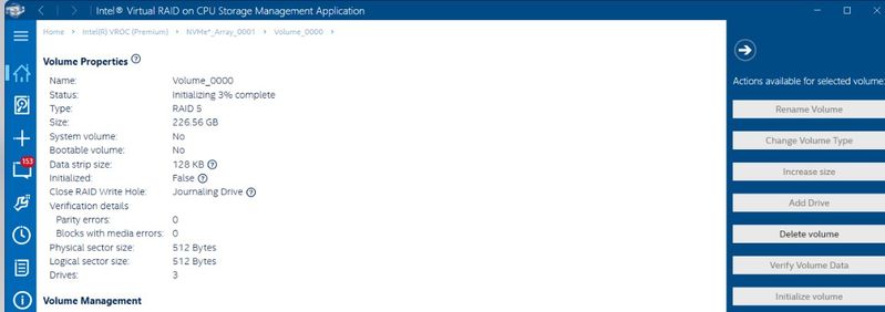

Hi @Dhamu1204
I do not understand very well your question, according to the image that you put you have a RAID 0 and you can see that it is working. The RAID 0 is the sum of the disks you have and is configured according to the smallest disk size, ie if you have 500 GB + 1 TB, you will never have 1.5 TB, you will have 1 TB and lose 500 GB of the 1 TB disk. And the image shows that a RAID of approximately 1TB
what I’m trying to do is break the existing RAID 0 volume and use both drives independently.
The issue is, I haven’t been able to find a way to delete or break the RAID volume — neither through the BIOS (since no option appears there) nor through the Intel RST Option ROM (Ctrl + I doesn’t work on startup).
Would appreciate it if you could guide me on how to safely break the RAID setup and use both storage devices separately on this laptop.
Thanks again for your help!
Delete button disabled.
In the BIOS you will not find it, your laptop was not designed to work in RAID, you have done something that is not normally done a RAID via software that I do not really know what its effect is.
Now disabling RAID will most likely cause you to lose all the data on both disks, I recommend you do a backuyp before doing these steps recommended in the Intel for.
