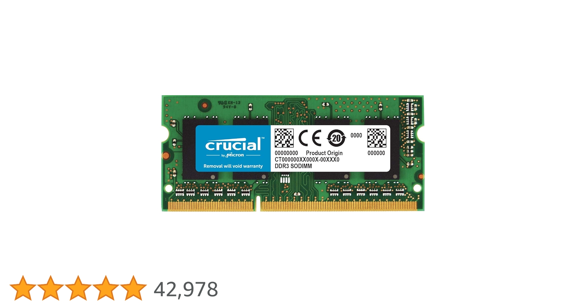

is this compatible RAM...???
for Your laptop: hp - compaq Pavilion g4 (Intel DDR3) :
https://www.crucial.com/scanview/3D56163331D926C3

Hi:
That's not the compatible part number I gave you...
This is the one from the report I ran...
Crucial 4GB DDR3L-1600 SODIMM | CT51264BF160B | Crucial.com

I don't see that Amazon.DE sells that particular part number.
The only one I could find is the one you found, but when I look up that part number all the places I can find indicate that it is a 2 GB memory chip, not a 4 GB memory chip.
I think you better see if you can find the part number I gave you someplace else.
