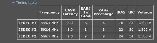

> 3. The memory speed listed in Computer Setup is 2133 Mhz and, the Windows indicates the same speed, but programs like SandraSoftware or CPU-Z says that the installed memory is actually a DDR4-2400. Why is that? Did HP install a memory faster than the motherboard can support?
Yes.  Most RAM has a small SPD ("Serial Presence Detect") chip, which contains a "Timing Table", e.g.,
that enumerates the various speeds that the RAM supports.
So, your "2400" RAM has declared that it will run at "2133" speed.
