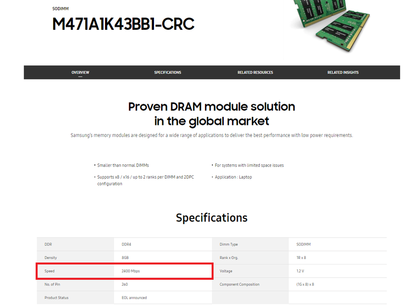

In Hardware Diagnostics Tool i have this information:
But on the Samsung site that model of RAM memory unit has 2400 MHz in tech spec.
In the service manual what you sent me, i have 2400 MHz RAM slots too for my Intel 7gen processor motherboard
Where is the mistake?
Hi:
Since I don't work for or represent HP, I can't say why they put that info in the service manual.
Even if you bought 2400 MHz memory, it is only going to run at 2133 MHz, which is the maximum speed any Intel 7th gen core processor can run the memory at.
Installing 2400 Mhz memory will not cause any issues, but it won't run at 2400 Mhz--only at 2133 MHz.
Thank you very much for information.
Just do not understand why they put in this laptop RAM memory with a frequency with which it can not work...
