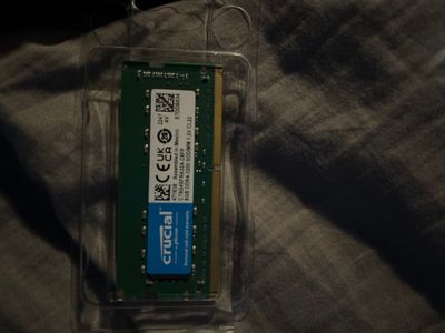

04-02-2023 04:04 PM - edited 04-02-2023 04:05 PM
@NonSequitur777 I’m not sure what you mean but I got crucial 8GB Ram sticks. I even looked at the website to see what would be compatible.
This is what I bought. One of them is now in my computer but if I put this one In it doesn’t want to turn on. I mean if I use both of them.
04-02-2023 08:02 PM
All right, that is what I needed, thank you. The RAM you showed is a Crucial 8GB RAM stick with p/n: CT8G4SFRA32A (see: https://www.crucial.com/memory/ddr4/ct8g4sfra32a) running at 3200 MHz. Since your laptop cannot run RAM speed above 2400 MHz, this RAM should down throttle to run at 2400 MHz without any problem.
My question is this: are both 8GB RAM sticks identical (brand and part number)? -Preferably, RAM should be installed using a matching kit. For best results, brand, model, speed and timings should be identical.
When I looked at OMEN By HP - 15-Ce0xx benchmarks here: https://www.userbenchmark.com/System/HP-OMEN-by-HP-Laptop-15-ce0xx/59252, it shows your motherboard ID as HP 8390. Please check this for me: type in system information in your Windows search bar, and look to the right of "BaseBoard Product", and if you can't find it there, type in cmd in your Windows search bar, right-click on the "Command Prompt" App, left-click on "Run as administrator", and click "Yes" to confirm, and copy/paste/enter the following command exactly as shown here:
