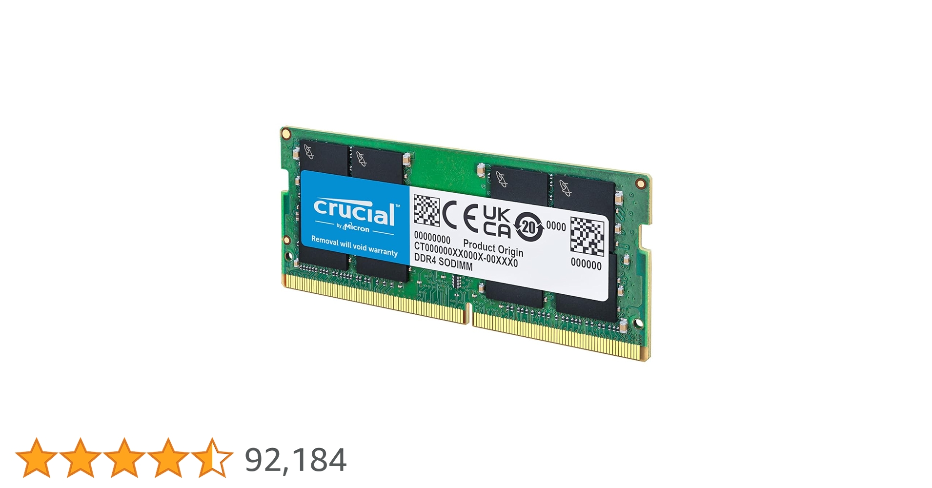

Your notebook's processor can only run the memory at 2400 MHz.
Here is the 8 GB DDR4-2400 memory chip that is listed on the above report on the Amazon, India website.
https://www.amazon.in/Crucial-8GB-DDR4-2400-SODIMM-CT8G4SFS824A/dp/B01BIWKP58/ref=sr_1_1?dchild=1&ke...
Before you buy the memory run the free utility that I zipped up and attached below to see what speed the memory chip HP installed in your notebook is.
It might be a 2666 MHz chip running at 2400 MHz.
If it is a 2666 MHz chip, then get this one instead so it matches the specs of the one in there now.
https://www.amazon.in/Crucial-CT8G4SFS8266-Unbuffered-SODIMM-Retail/dp/B071KNKBQ1/ref=sr_1_2?dchild=...

I can't see your screenshot, but yes...one of the Crucial memory chips should work fine with the Samsung one.
Just get a chip that is the same speed (2400 or 2666) as the Samsung one is.
as you said you cant view screenshot here the detail:: my memory speed is 1333.3MHZ (DDR4-2666/PC4-21300) thankyou.... and as you said to stick with my plan(adding 8gb(slot2) with 4gb(slot1)=12gb... so that I can max out by adding another 8gb in future (if I tried to do that in future it will become 16gb which is not supported) because in specification they said expandable up to 12gb...
The manual is incorrect about the total memory.
The crucial memory report is correct regarding the total memory of 2 x 8 GB.
If you can install 8 GB of memory in one slot, then you can install 8 GB of memory in the other slot.
Since your existing memory module is 2666 MHz, get this one...
