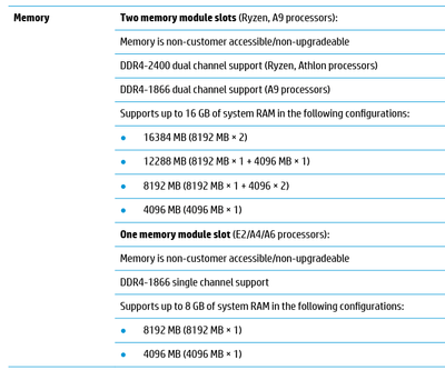

Thanks for the reply NonSequitur777.  This is very frustrating, with any other manufacturer I can look up specs with model & S/N (or Ser Tag) and get detailed information but not with HP.  Anyway it is an AMD A9 3.1GHs (reporting from Windows) and according to the chart below I would have to get DDR4-1866 dual channel support for A9 processor.  Why did the 4GB of DDR4-2666 work that came it the laptop.

That means your 2666 MHz RAM has 'bridged' (down throttled) to 1866 MHz as expected.
At this point in time, as mentioned, I would try a matching 2 x 8GB 2400 MHz RAM kit.
Kind Regards,
NonSequitur777
