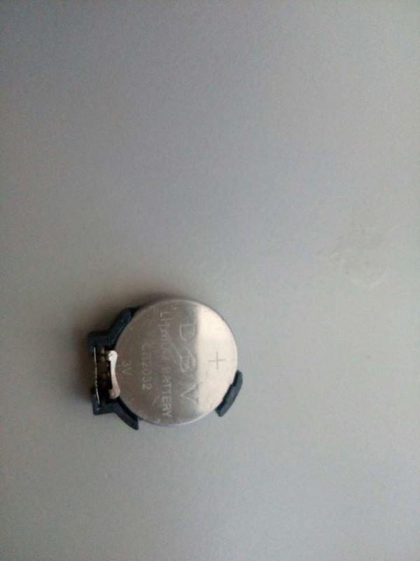

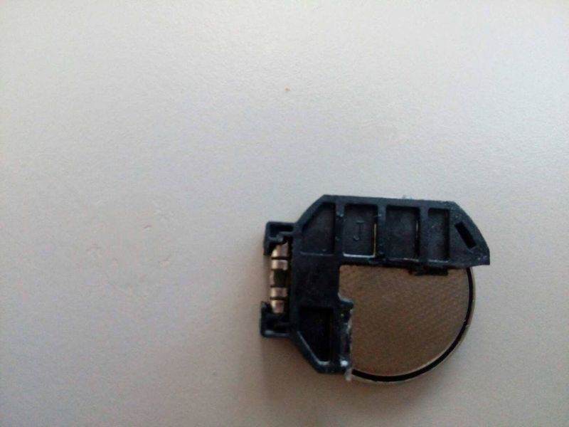

You don't actually mention which coin cell it is or battery it is.
Thank you for your suggestion
here are the photos of the battery
AND it doesn't have a reference number like 2032?
The pictures take hours to get approved, so maybe tomorrow.....
CR2032 And on the bottom i found J letter
