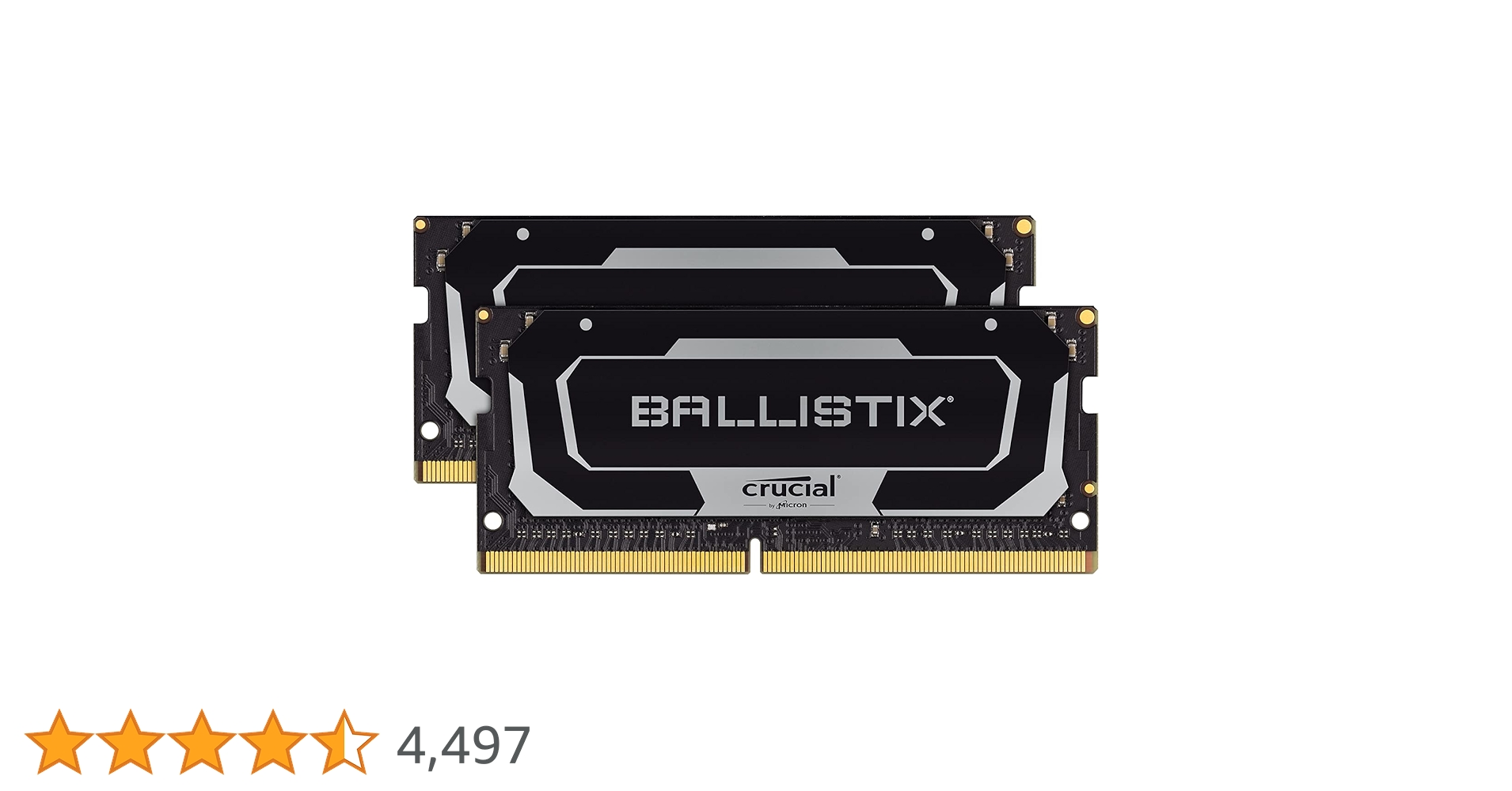

Thanks for replay. I check manual and I see my laptop support up to 32 GB 2666. I'm intrested in gaming version but there is only 32gb 3200 and 16gb 2666. But I found on Amazon.uk
I presume its also valid. It just for some reason its not shown on Crucial website. I'm right?
12-22-2020 12:11 AM
Oh I read comments. Crucial ram are without JEDEC and in order to use 2666 I need XMP profile. Im pretty sure my laptop doesn't has it. It's BIOS doesn't even allow me to turn off special keys.
Now I'm concerned Crucial are only one who are recommended by manufacturer. But they will not work as Intended with my laptop because of its BIOS
So I have to buy not recommended ones and hope it will work ?

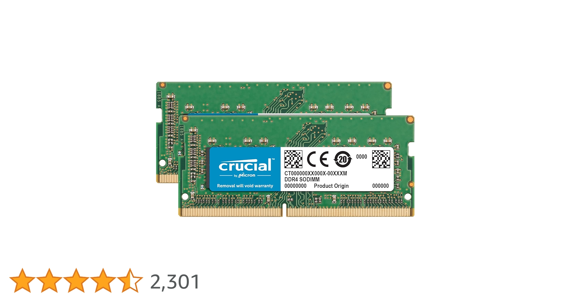

Ok One more question. Now I'm confused should I buy this
or this
One it labeled as Dual Rank and second without label which i guess means Single Rank
12-22-2020 02:27 PM
Run that utility again and it will tell you how many ranks the memory you have installed now is.
Buy whatever ranked memory the report indicates.
You will find that info like in the screenshot below for my PC:
12-22-2020 02:45 PM
According to this site, the memory that is not indicate whether or not it is single or dual rank is also dual rank.
CT2K16G4SFRA266 Crucial Laptop Memory (memory4less.com)
I checked the Crucial site itself and no rank specification is listed.
12-22-2020 04:17 PM
It's single. So I will just buy single one
