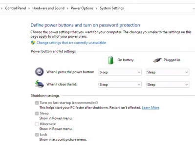

Check your power plan for the power button and makes sure the laptop turns off instead of just sleeping.   If you do not have it plugged in the battery will run down when sleeping.  In the below picture it should be either "Turn off" or "Hibernate"
Thanks for the speedy response and info. (I'm in the UK by the way).  I've checked the settings etc and all seem ok.  I had to have the battery replaced under warranty previously - and they agreed the battery was nor performing as it should have been,  Warranty has run out of course!
