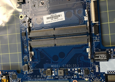

Which makes me wonder what your RAM slots look like.  If you could provide a close-up picture, that would help.

Thank you, NonSequitur777 for your reply!  When you look at the slot on either side, the pins don't line up the same.  The guiding slots are in different places (I'm not an expert, though).  The new memory board description is as follows:
Amazon Purchase Link: https://www.amazon.com/dp/B072QRDW31?psc=1&ref=ppx_yo2ov_dt_b_product_details
Picture of Memory Cards inside Laptop.  Note that the left slot has the original memory card and the right has the new one.
Hope this helps.  You see when  you turn around the memory card for the left side, the pins don't line up with the slots.  Thank you!

I guess I am not entirely sure what the issue is.  The HP p/n: L50262-601 ("MOTHERBOARD UMA i7-8565U WIN") RAM slots are supposed to line up as mirror images, with one RAM stick showing its frontside, and the other RAM stick showing its backside:
As seen here:
What I can see from your picture, is that the top 8GB RAM stick is a Hynix 8GB DDR4 HMA81GS6AFR8N-UH NO AC, and the one below is an HP 8GB DDR4 (p/n: 862398-855).  Even though you got different brands RAM sticks, they should run fine, at 2400 MHz, and in dual-channel mode.
SK Hynix 8GB DDR4 1Rx8 PC4-2400T HMA81GS6AFR8N-UH SO-DIMM Laptop RAM Memory at Amazon.com
Please shut down your laptop, removing power and disconnecting your battery, and line up both RAM sticks as shown in my first picture, take a picture, and post.

Thank you, NonSequitur777!  I didn't realize that you could install upside down.  I thought there was only one way to install.  I will try and send you pictures.  Thank you, again! (I'm definitely learning!)
