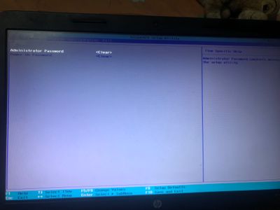

Please send screenshots of all BIOS settings.
If one of the following data is shon, please blur
- serial number
- device id
- UUID
(1) Change BIOS settings to ...
System Configuration > Virtualization <Disabled>
System Configuration > Boot Options > Legacy Support <Disable>
System Configuration > Boot Options > Secure Boot <Disabled>
(2) Save BIOS settings and exit
(3) Test/Boot again ...
