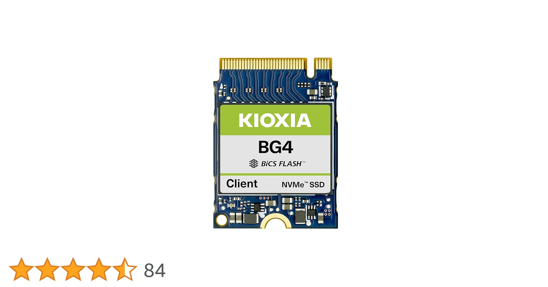

Thanks for the response. Let me make myself more clear.
The Nvme drive in my laptop (kioxia kbg40znv256g) is not 2280 but 2230. It is shorter.
I am trying to find out if the slot in the laptop can host a 2280.
In the link below you can see the current drive.
https://www.amazon.de/-/en/Kioxia-KBG40ZNS256G-Client-NVMe-PCIe/dp/B0866BPJPG

So you have not actually seen the M.2 SSD? The product identification you put in your first post is for a 2280 SSD. The product you speak about in your later post with a picture is different and is a 30 mm disk. The laptop can take 32 gigs DDR4 memory.
The product came with a 256MB Nvme in 2230 format (shown in the link in previous post).
I am trying to find out (without disassembling my PC) if a 2280 will fit into it or not.
The answer should be "Yes, it will fit" or "No, it won't fit" or "Not documented anywhere, disassemble your product."
