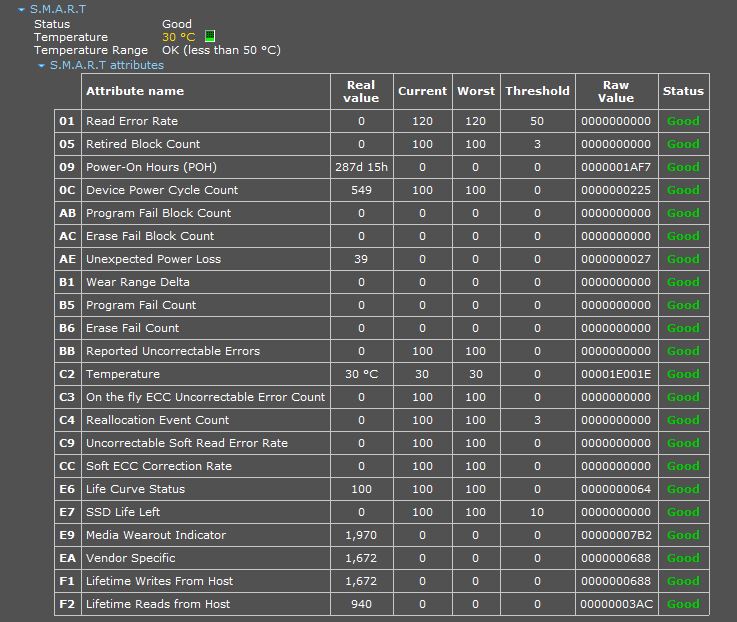

SPECCY gives information like:

Here is the output of one of the new drives (this drive would accept an OS) from Speccy:
Manufacturer Kingston
Product Family SSDNow
Form Factor 2.5-inch
Heads 16
Cylinders 60,801
Tracks 15,504,255
Sectors 976,768,065
SATA type SATA-III 6.0Gb/s
Device type Fixed
ATA Standard ATA8-ACS
Serial Number 96IACKS8T
Firmware Version Number AM0P2A
LBA Size 48-bit LBA
Power On Count Unknown
Power On Time Unknown
Speed 5400 RPM
Features S.M.A.R.T., APM, NCQ
Max. Transfer Mode SATA III 6.0Gb/s
Used Transfer Mode SATA II 3.0Gb/s
Interface USB (SATA)
Capacity 465 GB
Real size 500,107,861,504 bytes
RAID Type None
S.M.A.R.T
Status Unknown
Partition 0
Partition ID Disk #1, Partition #0
Size 512 MB
Partition 1
Partition ID Disk #1, Partition #1
Size 465 GB
