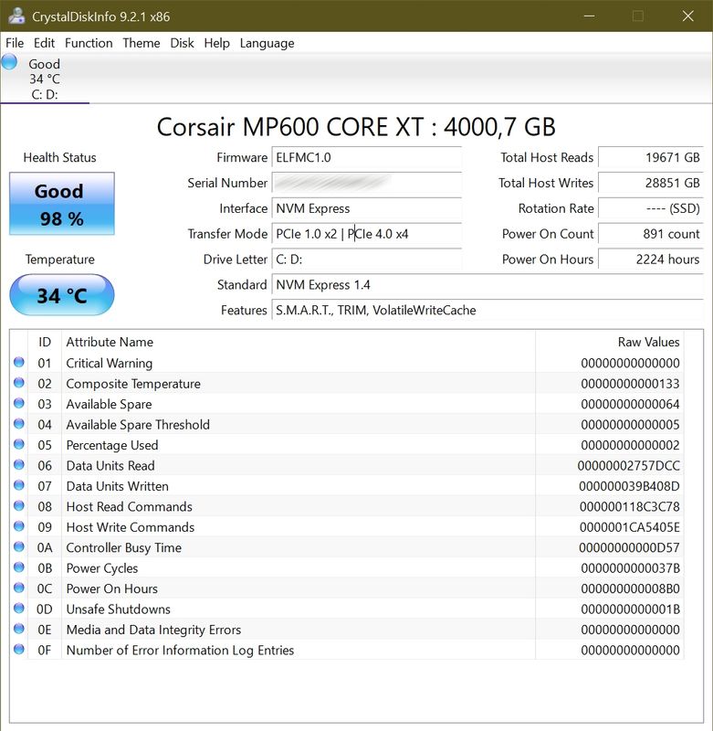

The issue is that the laptop from 2019 uses PCIe 1.0 x2 data transfer mode only, instead of PCIe 4.0 x4 what should be supported both by laptop and is supported by SSD.
Laptop is using latest bios available, SSD as well. The disk is not throttling, the temps are around 35 C.
The BIOS doesn't offer any option whatsoever regarding configuring hard drive and/or PCIe.
Can someone help?

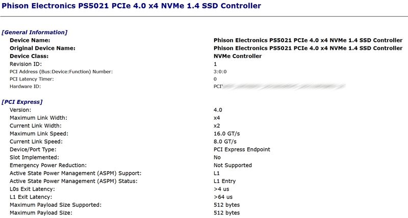

Using HWiNFO64, it confirmed the controller supports PCIe 4.0 x4 mode

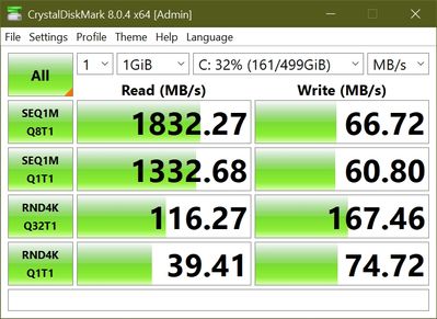

Changed this setting:
Added the results of Crystal Disk Benchmark with changed test sizes. Still far away from expected results:
Some of those speeds contradict the Crystal Disk Mark current mode of PCIe 1.0 x2 so it is not clear what is going on. I will try other SSD in this laptop, and this particular SSD in other laptop(s) and post the findings here.
