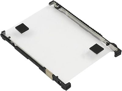

I already bought a 'bracket' (L24490-001) for my SSD SATA 2.5" but i don't know how to use/install it to my SSD SATA 2.5" slot in my laptop because there's no screw/bolt to make sure it's not shaking or loose. Is there any additional parts i should buy?

No, the image is NOT the right part. Where did you get the information from ? Your machine has 2.5" drive already, its specs

Anyway, from your photo, sounds like your machine has M.2 drive but not 2.5" SATA drive. You also need  Hard drive cable part # L23187-001 and few screws. Page 36 of the following manual shows you how.
       http://h10032.www1.hp.com/ctg/Manual/c06242992.pdf

You have to combine TWO answers. Definitely you have to buy the HDD cable as mentioned on my previous reply.
