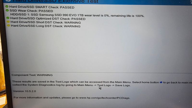

I purchased an HP 17-cn4047rn and am trying to get an SSD I installed internally (separate from the C drive) to be recognized. I used what I believe to be the correct SATA to motherboard cable - listed as "New Genuine HP 17-CN 17-CP 470 G10 HDD Hard Drive Connector Cable M75893-001".  But it is not seen by explorer or Disk Management.  It is correctly seen when the SSD is connected externally with a SATA to USB cable.  I installed the latest BIOS but this had no affect.  I ran the Hard Drive/SSD test and received a couple of warnings (see image attached).  I upgraded from windows 11 home to pro but that didn't help.
Hard Drive/SSD test resultsHard Drive/SSD test results

Run Hardware Diagnostics: Since you've received warnings during the hardware test, run a comprehensive diagnostic on the SSD and the internal storage setup. You can use HP PC Hardware Diagnostics (downloadable from the HP website) to check for any potential hardware faults. This could help pinpoint if the issue lies with the SSD or the laptop’s internal connections.

The BIOS version F.07 seems very limited. I see nothing related to the sata ports.  The new drive cannot be initialized in disk managment because disk management doesn't see the drive.  I am on my second cable and have tried to use a different samsung SSD. If I cound attach a file, I could provide the test logs from the Hard Drive/SSD Extensive test from HP PC Hardware Diagnostics. see image below.  version 10.7.0.0 of these diags give the same result.
