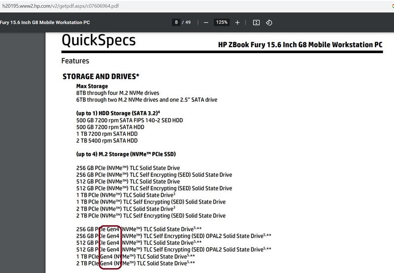

This issue concerning the ZBook G8s has been discussed before. Unfortunately HP chose to grace only the Power Zbook G8s with a Gen 4.0 slot and left the Studio and the Fury G8s with Gen 3.0 slots. These laptops all share the same 11th Gen TigerLake processors, but the laptop designers didn't connect the CPU PCIe 4.0 lanes to the m.2 slots on your laptop and on the Studios. You can see the relevant discussion here: https://h30434.www3.hp.com/t5/Notebook-Hardware-and-Upgrade-Questions/samsung-980-pro-on-Zbook-Studi....
HP has also managed to pull off these cockamamie shenanigans on some AlderLake laptops, as seen here: https://h30434.www3.hp.com/t5/Notebook-Hardware-and-Upgrade-Questions/Does-the-M-2-Expansion-Slot-in.... And I'm pretty sure Alder Lake laptops support Gen 4.0 m.2 drives, even though their expansion options still have the chipset as Gen 3.0.........  I completely agree with Paul_Tikkanen EXPERT Level 21 that it's "hard to believe that robust notebook does not come with PCIe Gen 4", alas it's unfortunately true. Page 8 of your product's datasheet will tell you everything you need to know: HP ZBook Fury 15.6 Inch G8 datasheet. Gen4 drives ARE compatible and offered with this series, but are "downgraded" to plain "slow as molasses Gen 3" speeds.
