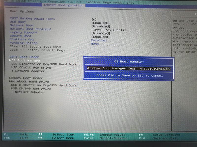

Yes that's right. However, we should be able to adjust the boot order in the BIOS....what shows up in boot options if you have just the NVME M.2 in place?
The same as before:
With legacy the same
Did you do the clone with secure boot enabled or disabled?
Enabled

Finally I made a clean install of windows on the SSD and then I had to full format the HDD deleting all the partitions... without that it was always asking from where to boot windows.
So now is finally working. Thanks!
