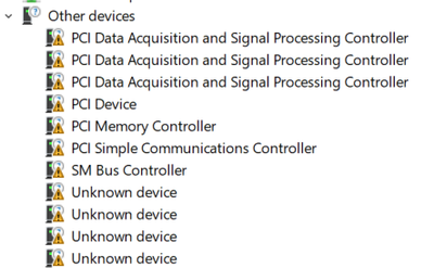

I also have this in other devices.
The above devices have been remedied.  The 970 Evo Plus problems still exist
