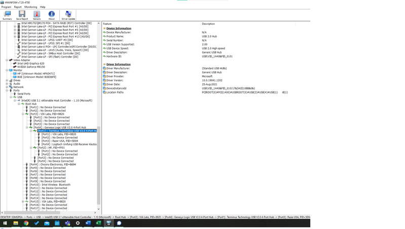

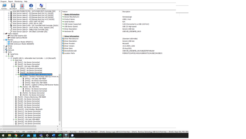

USB Ports:
See attached pictures. These should be related to the dock (the mouse and keyboard are connected to it).
There's something weird going on – the dock is connected to a USB C port (port 4, page 4 of the manual), which should be 3.0, while the speed of the devices connected state it’s operating on 2.0 speeds.
