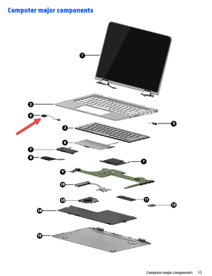

The part that you need is
Power connector cable 801513-001
It is actually a modular part that plugs into the notebook's system board.
Maintenance & Service guide for your notebook.
http://h10032.www1.hp.com/ctg/Manual/c04807803.pdf
You can have it replaced at a laptop shop, unless you want to do it on your own. It does require disassembly of the notebook.
It is an inexpensive part.

Thanks @erico.  Replacing the power connector worked!  Once the connector was out, I could see that one of the wires had disconnected from the pin.  The laptop didn't end up needing a fully disassembly - basically the heat sink and fan that were on top of the connector wire, which made it a lot easier  So glad to have my laptop powering up again!
