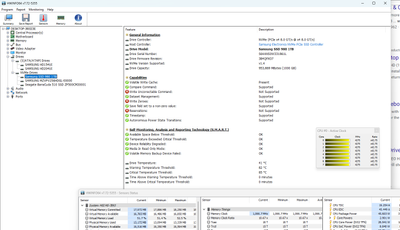

I suggest running HWINFO instead of SPECCY. I have both and find HWINFO provides much more information.

CMOS battery,I never even thought of that! Could that really cause such an issue? These are results from the Speccy scan showing SMART drives and faults all good here. I just don't want to start this whole system restore to a new disk if I don't have to. I'm cleaning the drive, no malware no viruses, it's driving me nuts!!!
