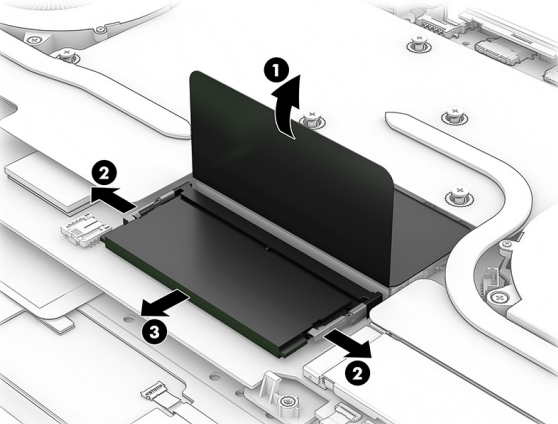

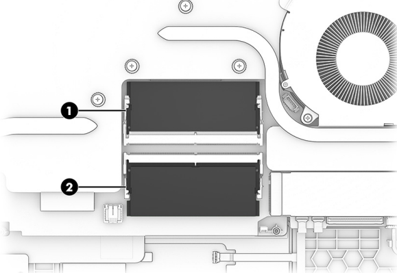

Memory modules
To remove the memory modules, use this procedure and illustration.
Before removing the memory, follow these steps:
1. Prepare the computer for disassembly (see Preparation for disassembly on page 33).
2. Remove the bottom cover (see {Xref Error! Target does not exist.}).
3. Disconnect the battery cable from the system board (see Removing and reinstalling the same
battery on page 36).
If you are replacing a memory module, remove the existing memory module:
1. Lift the protective cover (1) from the memory modules.
2. Spread the two retention clips (2) outward until the memory module tilts up, and then remove the
module (3). Use the same procedure to remove all memory modules.
