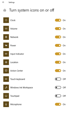

Also, I noticed that when I went to "Turn systems icons on or off" in Windows settings, when I toggle the touchpad icon to "On", it automatically shifts to "Off" when I exit settings. Here's the screen:
This is frustrating because the new, non-adjustable touchpad settings are much different from how I'd had it set up previously, and not being able to open a user interface to adjust anything means I'm stuck with a relatively poorly functioning touchpad. Any ideas what's going on and how to fix this?
